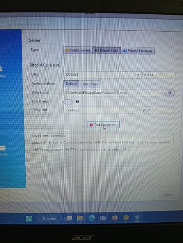

Failed to connect Sparrow wallet to bitcoin knots
Hi,Mr.Paul
Kindly find the attachment.
Thanks.

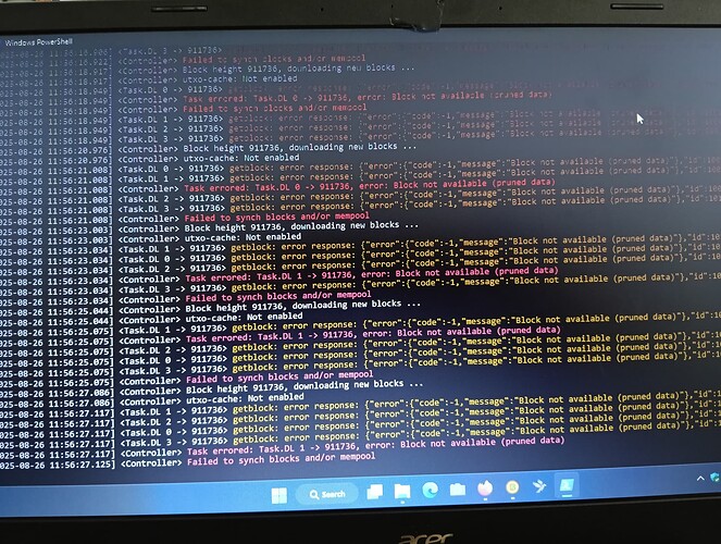

Hi,Mr.Paul
Kindly find the attachment (Fulcrum).
Thanks.
Haha, yes I know it was the bottom of the log. I just meant that I don’t recall the terminology for the root/origin of a stack trace (whether it is called the “top” or the “bottom” of the stack). It’s been a minute since I went to college. Anyway, doesn’t matter. The log didn’t have anything new in it to help.
The latest findings seems to indicate the problem is not with Sparrow (since Fulcrum also cannot connect to the RPC). I think this means the most likely cause will either be the RPC port has a conflict, or connections to it are blocked by some security feature.
The only other test I have for you is to repeat the test where you tried a different port, and use some other different ports. Basically, you shut down Knots, change the rpcport in bitcoin.conf, start Knots back up, then update the port in Sparrow to match. If you try a bunch of different ports and none work, then we can rule out a port conflict.
To continue diagnosing your current native installation of Knots, you will likely need to connect with somebody who has solid Windows technical expertise, who knows how to navigate Windows networking configurations and security features.
If you want, I can give you the connection details for one of my test servers, and you can try connecting Sparrow up to it over Tor. If that works, then at least you’ll know a last resort would be abandoning your native installation of Knots and switching to an instance running on the Start9 operating system. I know that would technically be giving up and not actually solving the problem, but unfortunately we’ve reached the limits of my own expertise on a native Windows installation of Knots.

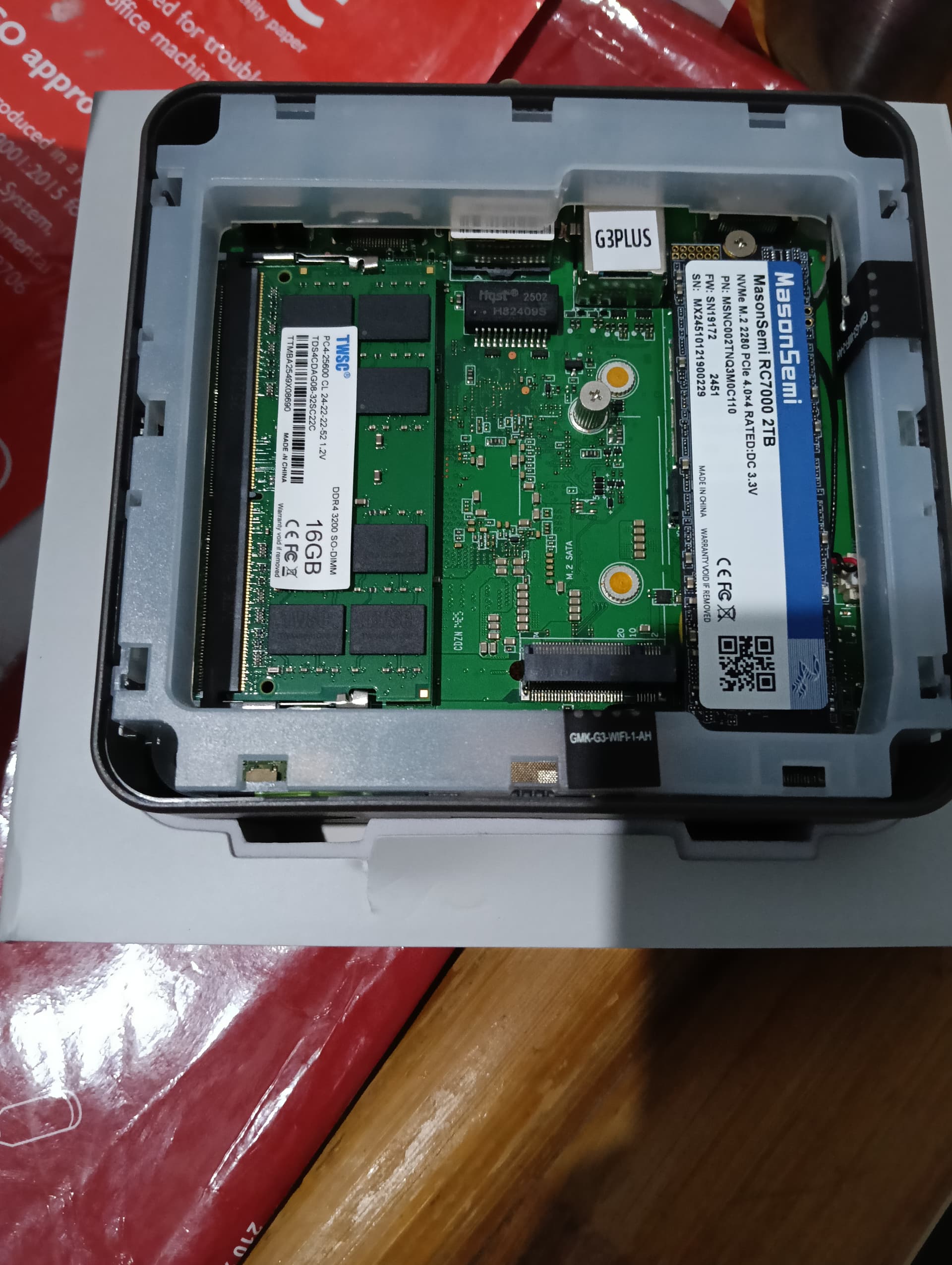

Hi,Mr.Paul
I have set the G3 (photo attached).
For your instruction steps above, would you mind sharing any link to download (StartOS, Balena, Bonjour, Electrs,etc.).
Thanks.
