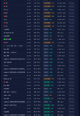

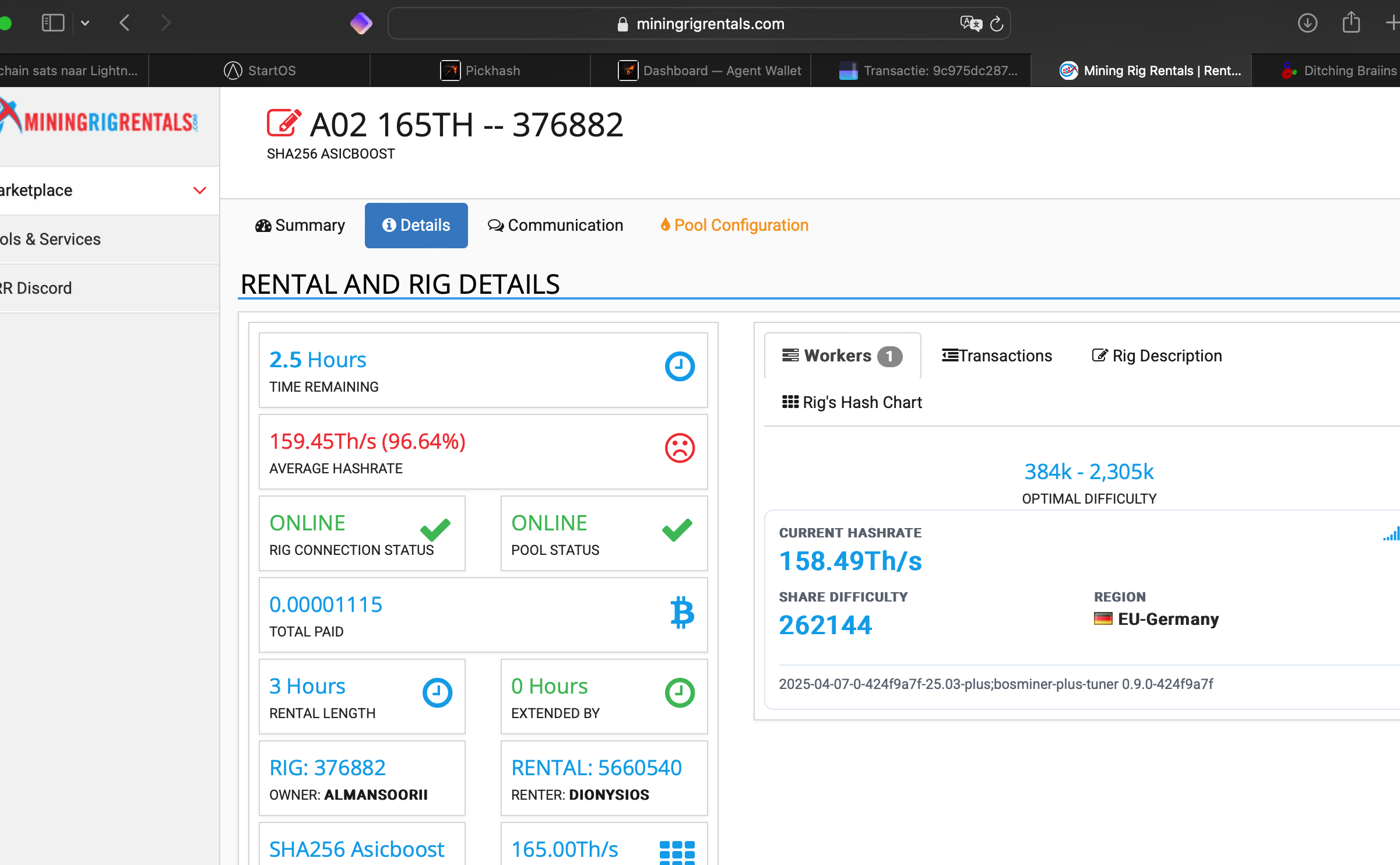

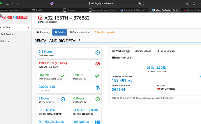

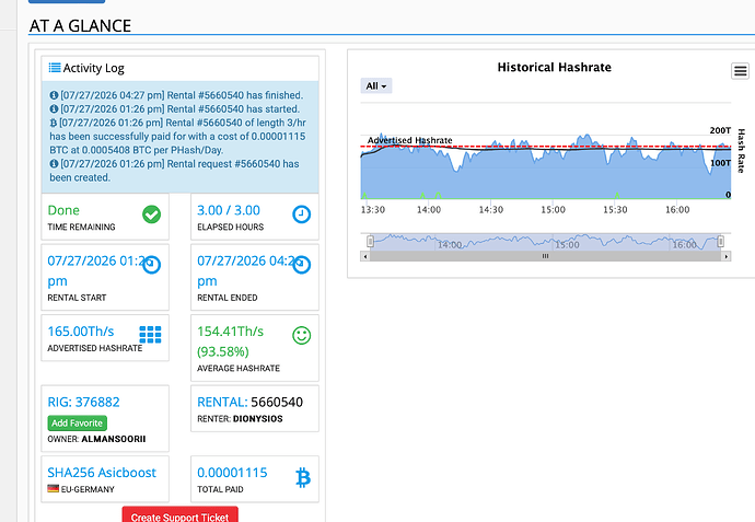

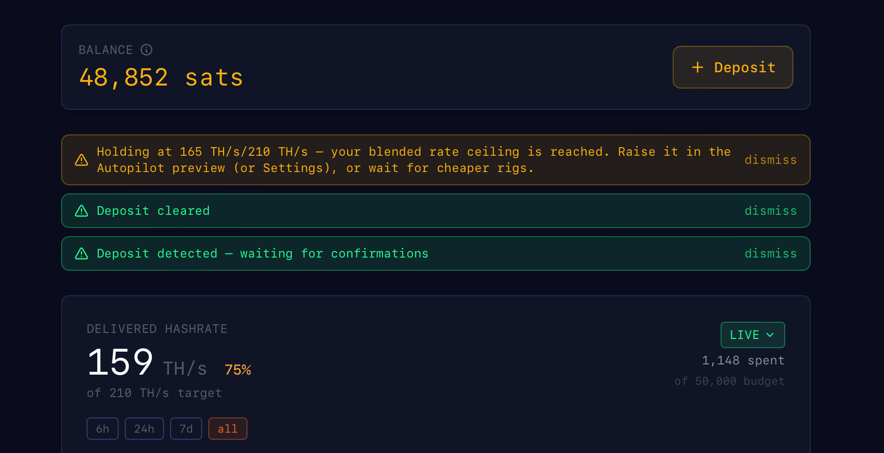

Still looking if it works and what to do.. See screenshot for feedback.
That first message just says the available rigs are more expensive than the rate cap set for the session, so it couldn’t fill up to your target hash rate without paying more than you want. The cap can be increased in your next session if you are willing to pay more to get the hashrate, otherwise it should resolve as the market fluctuates and cheaper rentals appear (you’ll just be mining under your overall targeted hashrate in the mean time)
I’m not sure on the red frowning face since it seems to be showing 96.64% of the reported hash rate if I’m reading it correctly, which usually gives you a green smiling face. What do you see in the My Rentals > Current Rentals > SHA246 Asicboost tab?

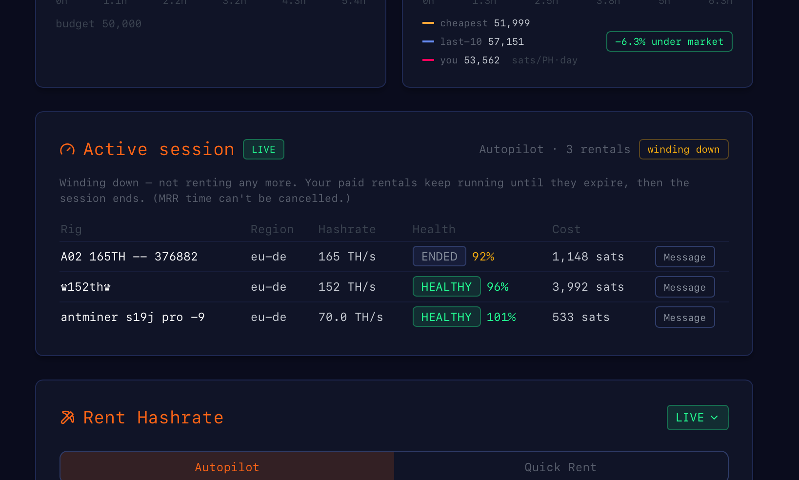

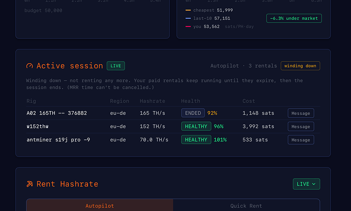

The session on MRR is finished but in Pickhash it says ‘winding down’ don’t know why we can not start a new session?

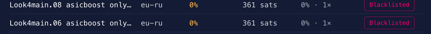

That particular operator took 361x2 but there was no refund. I imagine the 0% Delivered didn’t trip the under - performance flag. The 361x2 is not worth disputing but dont want the server hitting my bids again
Maybe…Winding down is just spending the remaining sats the last 2 rigs cost. They haven’t showed ended yet. Have you got a history report for session yet?
no history report on pick hash so far. w’ll wait and see. history of MRR in screenshot

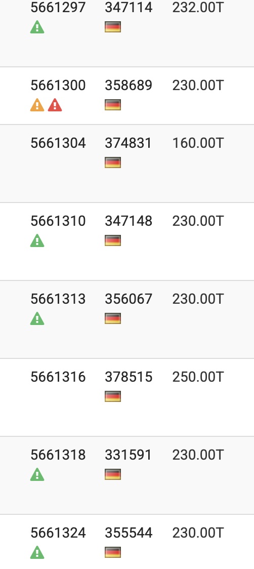

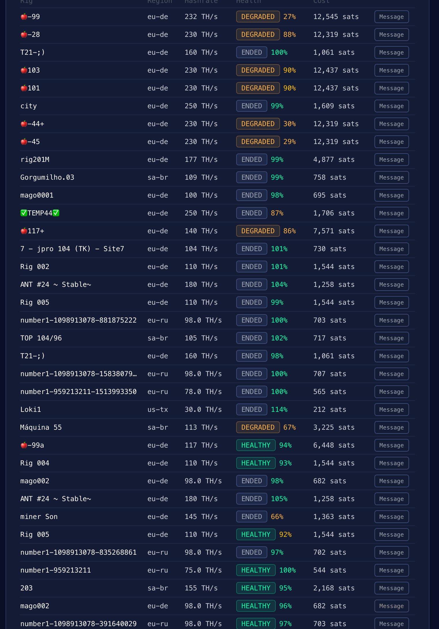

Green triangles - rejected shares are elevated on this rental.
Red triangles - rejected shares significantly elevated on this rental. Fallback pool (OCEAN) is active.
Changing those seems to have attracted a lot of 200 Th/s miners. I was aiming for higher rentals (1 Ph/s range)

BTW, if you use Stop session, it doesn’t cancel anything, it just stops renting more rigs. The current ones play out for their rented duration.
Kind of what I thought but wanted to confirm, Thanks

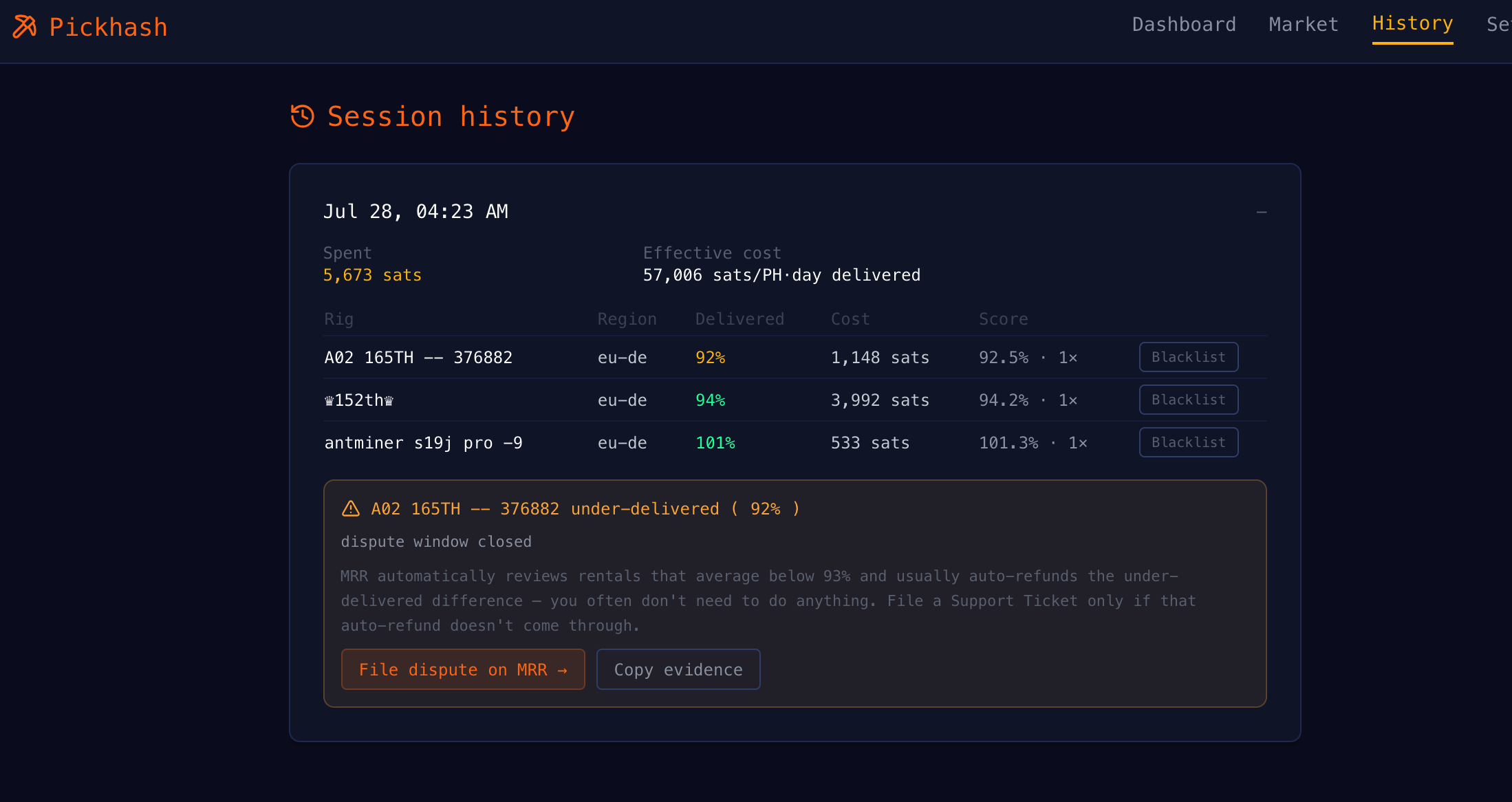

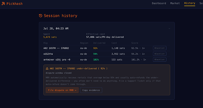

Today de winding down is finished and there is a history in pickhash. Any feedback is welcome. See screenshot:
Since I rent in Ph/s per day I think Ill forgo tweaking Datum and go back to default. Way to many smaller miners are trying to get a piece of the pie and many of them are Degraded.
No real feedback other than to say it looks like you are renting well under 1 Ph/s?
Otherwise your screenshot looks fine. Do you have specific concerns about your recent rental?
