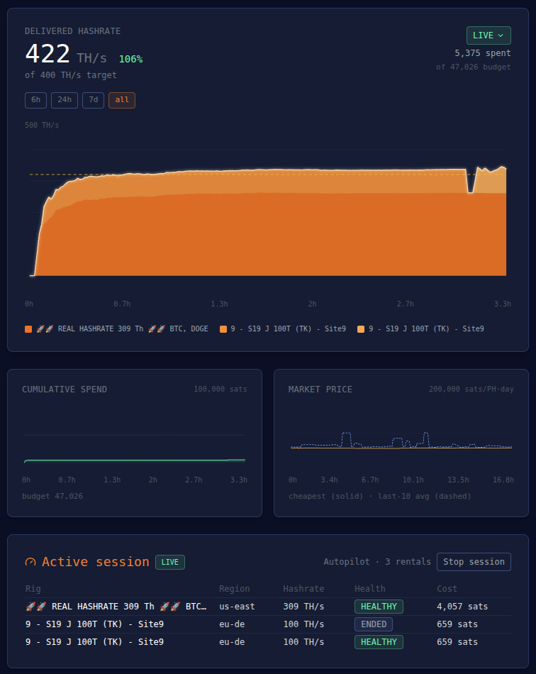

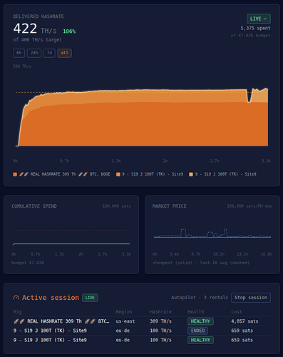

Next milestone reached. Autopilot auto-extended one rental, the other rental rejected the extension request, and it rented another to take its place (interestingly, the name looks like the same rig that rejected the extension :slight_smile: ) Short blip during ramp up and now back in business:
Auto-pilot rents rigs at min length (which is typically 3-hours), to reduce the impact of an underperforming rig and to potentially use that information when deciding whether to extend or to swap for a different rig. It requests an extension at 30 minutes before end, and if rejected it plans the next rental to minimize the ramp-down/ramp-up period.

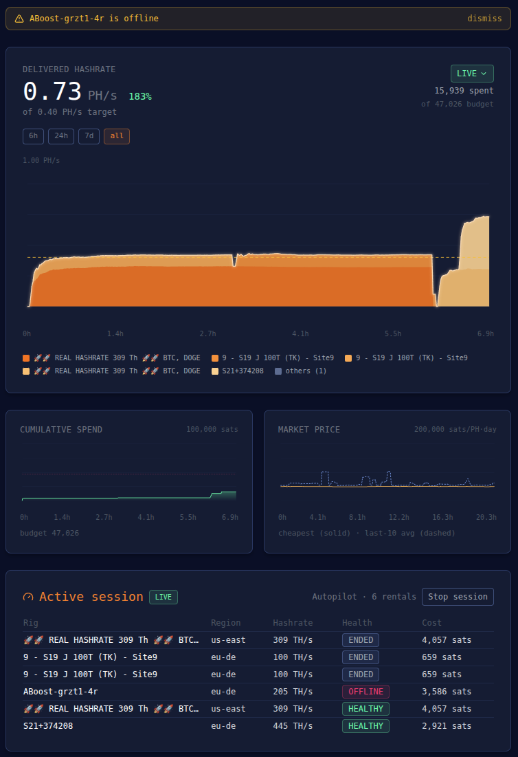

Getting back to the first live run, one issue has surfaced (this is why live production tests are important)
Looking at the telemetry, it looks like the sequence of events was:
  1. Two old rigs expired, and autopilot moved to refill my target of 400 TH/s.
  2. It rented a rig for 205 TH which never delivered a single hash (stuck 0%, now confirmed “offline”). Dead-weight spend of ~3,586 sats which should auto-dispute when the window opens.
  3. With that rig contributing 0, a ~91 TH gap remained. Autopilot made a mistake and tried to fill it by renting a 444.8 TH/s rig. It needed ~91 TH and bought 445!
That last step is obviously where the problem happened. The logic’s “greedy fill” is improperly ranking cheapest-first over best-fit. This can lead to a small top-up gap being filled by a large rig. This should be easy to fix. I’ll let the live run complete though to see if anything else interesting emerges.
